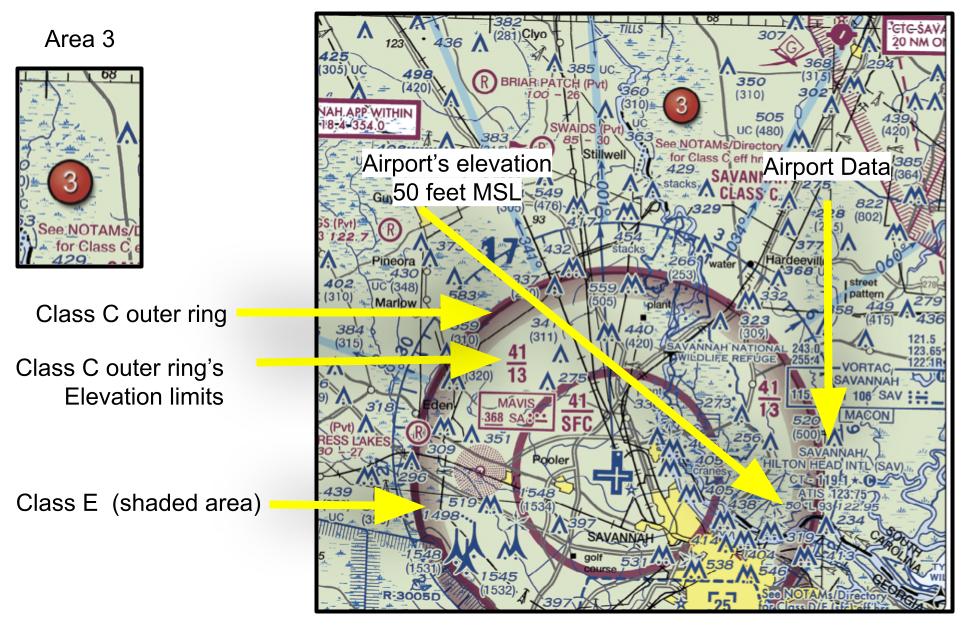

(Refer to FAA-CT-8080-2H.pdf, Figure 23, area 3.) What is the upper limit of the airspace immediately surrounding the Savannah/Hilton Head International Airport?
Imported item 7
The correct answer is:
First, head over to Figure 23, area 3 of the FAA-CT-8080-2H.‍ Area 3 is denoted by a red wine color circle with the number 3 inside of it. The Class C airspace is denoted by solid magenta rings.
For the innermost ring, we see a fraction of 41/SFC. This fraction signifies that this ring of Class C airspace starts at the surface and it tops at 4,100 feet MSL. Numbers in the figures are all presented as mean sea level elevations unless those numbers are presented inside parentheses, then they are above ground level (AGL).
We see none of the answer options show 4,100 feet MSL, so the answer must be in AGL units. We must convert this number then.
Recall an above ground level (AGL) elevation is distance from that object to the ground immediately below it. However, there is another distance which is from the ground to the mean sea level. When the sectional chart says Class C airspace ends at 4,100 feet MSL, that means it’s the elevation from the sea to the ground plus from the ground to the object. To get the AGL, we must subtract the elevation from the sea to the ground.
We can find the airport’s elevation above sea level by looking at the sectional chart. The elevation for the airport will be noted as a number followed by an “L” located under the airport name (see solution figure).
We see that Savannah’s elevation above mean sea level is 50 feet. Therefore, 4,100 feet MSL is equal to 4,100 - 50 feet = 4,050 feet AGL.
That's correct! Good job

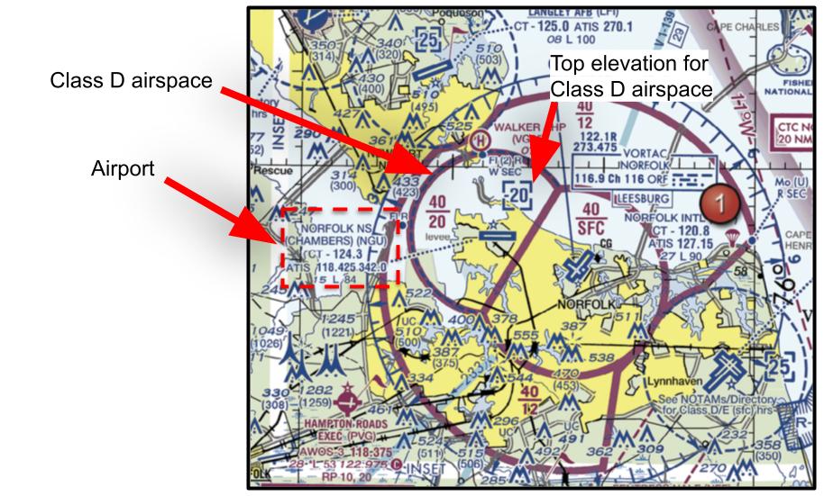

(Refer to FAA-CT-8080-2H.pdf, Figure 20, area 1). Suppose you are tasked to fly around Naval Station Norfolk Chambers Field (Norfolk NS Chambers NGU) Class D airspace. What is the top elevation of this controlled airspace?
Imported item 8
Class D airspace is denoted with a dashed blue line. Class D airspace’s top elevation will be denoted by a number in blue inside of square brackets with dashed blue lines.
If you see the top elevation with a negative sign, note that it means that elevation is what is noted minus 1 foot as there is another airspace that takes over higher elevation.
In this case, Class E airspace starting at 2,000 feet MSL starts right after Class D airspace ends at 1,999 feet MSL.

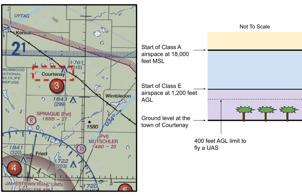

(Refer to FAA-CT-8080-2H.pdf, Figure 26, area 3). Which airspace(s) classification(s) is/are present above the town of Courtenay?
Imported item 11
I. Class A II. Class E starting at 1,200 feet AGL III. Class E starting at 700 feet AGL IV. Class G
For areas where the sectional charts don’t show any airspace markings, these are the airspaces present in order from bottom to top:
Class G is an uncontrolled airspace (no permission required) present from the ground surface up until the next airspace up in the vertical stack starts, which is Class E.
Class E starts at 1,200 feet AGL and goes up until Class A airspace starts which is at 18,000 feet MSL.
Class A airspace is where large airplanes fly long routes.
